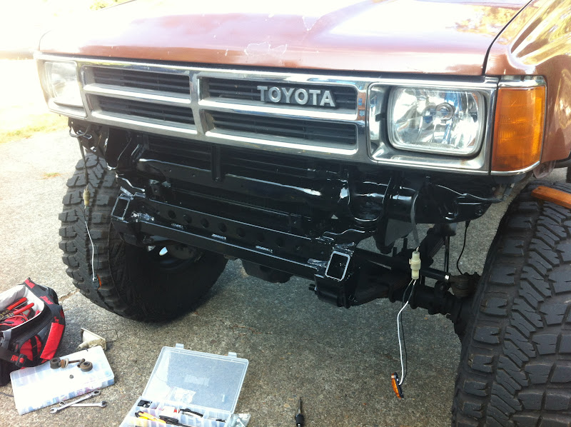

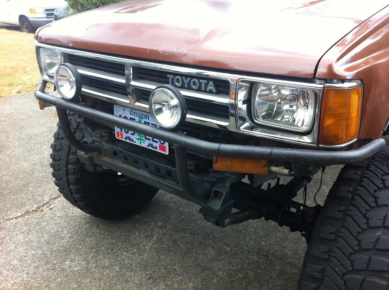

I got my Marlin Crawler front bumper a couple weeks ago and figured it was time to get it on...
First thing was to get this ugly thing cut off...
and get rid of these blinkers...
So I cut off old..
Meanwhile painting the new..
A little bit of grinding..
All clean and ready for new...
Bolted up...
And with my trailgear blinkers temporarily mounted..
Still more to come.. I need to weld on the stinger, light tabs and lights, and weld blinker brackets on...
