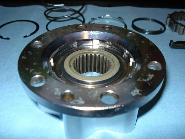

update: on order marlin rear hanger parts.
wheel beering took a poo   so did them    but i do have one ?   are the hubs rebuild able  I have slop  and i can feel/hear it driving9 hubs locked)   this part--> http://forum.ih8mud.com/attachment.php?attachmentid=135798&stc=1&d=1176619994

unclejpl4x4
well  know why you think that  ifs shaft    I do have to do the outer boots    but they where fine last wheeling trip.   so anyways the pick of the ifs hub  theres play/slop     Im going to work
on my day off and im doing the drives side  beerings.
