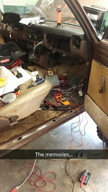

My friend that's all about some wiring lives a little north of here and wouldn't be able to come down for a while, so yesterday got it loaded up and hauled to his house. Looks odd between his ls400 and his mr2 with a 2gr swap. :driving:

Ole rig fired up tonight. Wiring not finished but it ran

donteatbugs
I got it to fire up and all the gauges work except the oil pressure (no sender). I have the fan wired in and will be working on little stuff the next couple days. This is my second 3rz wiring swap. The 22re was a lot easier than this one.
redneckcustoms13
you are the man, sorry it isnt as easy as the re-rz swap you did for Frank. i wish i had the knowledge and patience to deal with that headache.

Thanks. I hope to get it on the road soon. With ben tackling the wiring that took the load off my back and it's just patiently await his phone call now.

All done for now. Waiting on Hunter to bring a drive shaft and front transfer case seal. Also the IAC is unresponsive. It will need to be dismantled and cleaned thoroughly .
