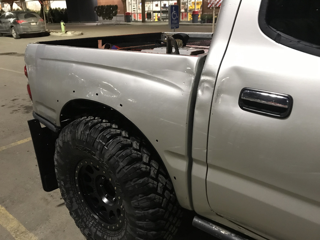

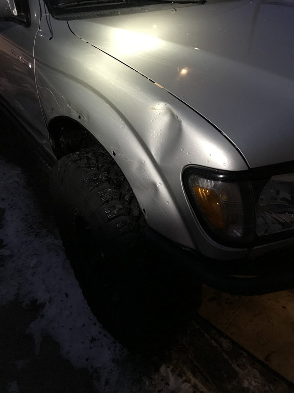

Some of the body damage I’ve gotten over the last couple months.
Both sides are wrinkly now.  But I’ve earned every dent and scratch.
Thats’s caught up.   More fun to come.

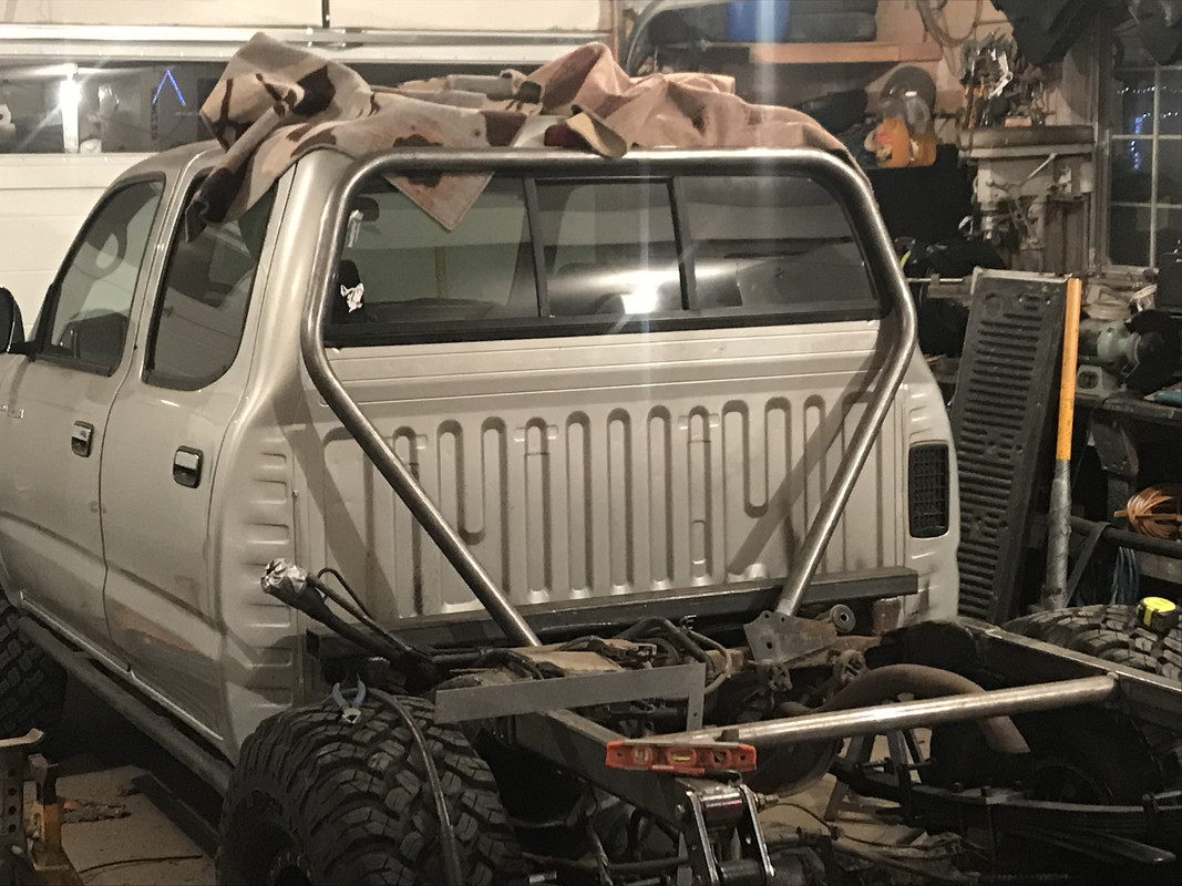

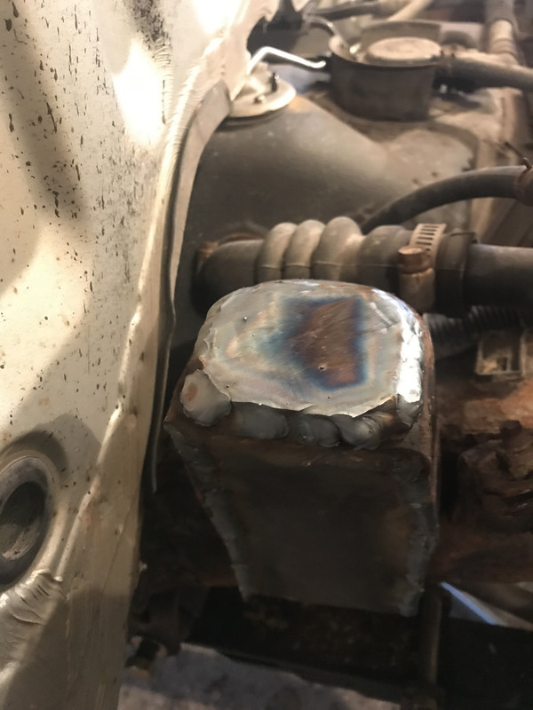

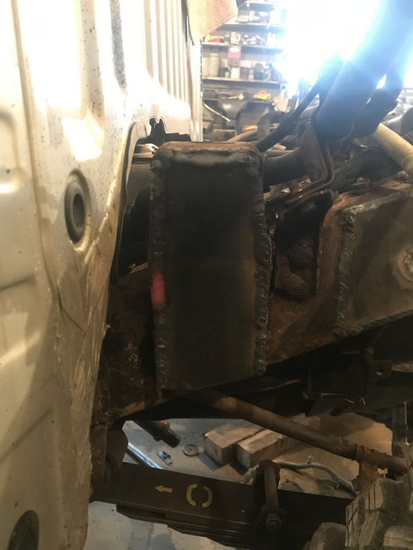

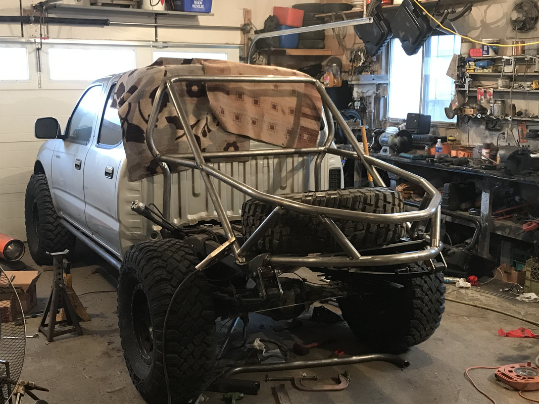

More progress
Welded in rear leaf hangers
Boxed in bed mount for cage mount
Plated top of bed/cage mount
Bent some tube- Did a somewhat complex bend for the hoop(for me)

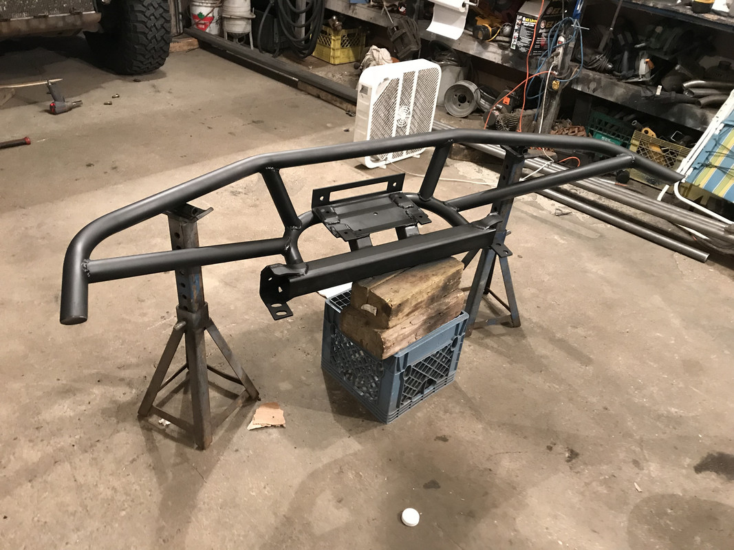

I like this and the direction it is going. I assume you cut off the little bumper like thing that was up front before building the tube bumper? I'm about to start on mine shortly and have been looking for ideas. Your is about the most simplistic and best looking I have seen. All of the bolt ons are ridiculously expensive when you figure what you can build it yourself for.
Thanks man, I built it like this
Hope that helps

Saw your pics on the shoutbox. I feel like the main hoop could have been bigger? Should be fine if you don't plan on rolling it. Looking great!  :biggthumpup:

The radiator looks, from the photo, very vulnerable to potential damage?
Gnarls.
rapier46 [OP]
  • Offline Rock Master
  • Turtle Points: 221
  • Male Posts: 249
  • Member since Sep '10
  • Granite Guru
    • View Profile
Re: 2003 Tacoma Crawler
« Reply #29 on: Dec 25, 2018, 01:48:49 PM »
Gnarls.
It definilty is.  I bought a 4” shorter rad that sits flush with the frame
Ran out of welding gas today and I’ve only gotten to here   :down:
