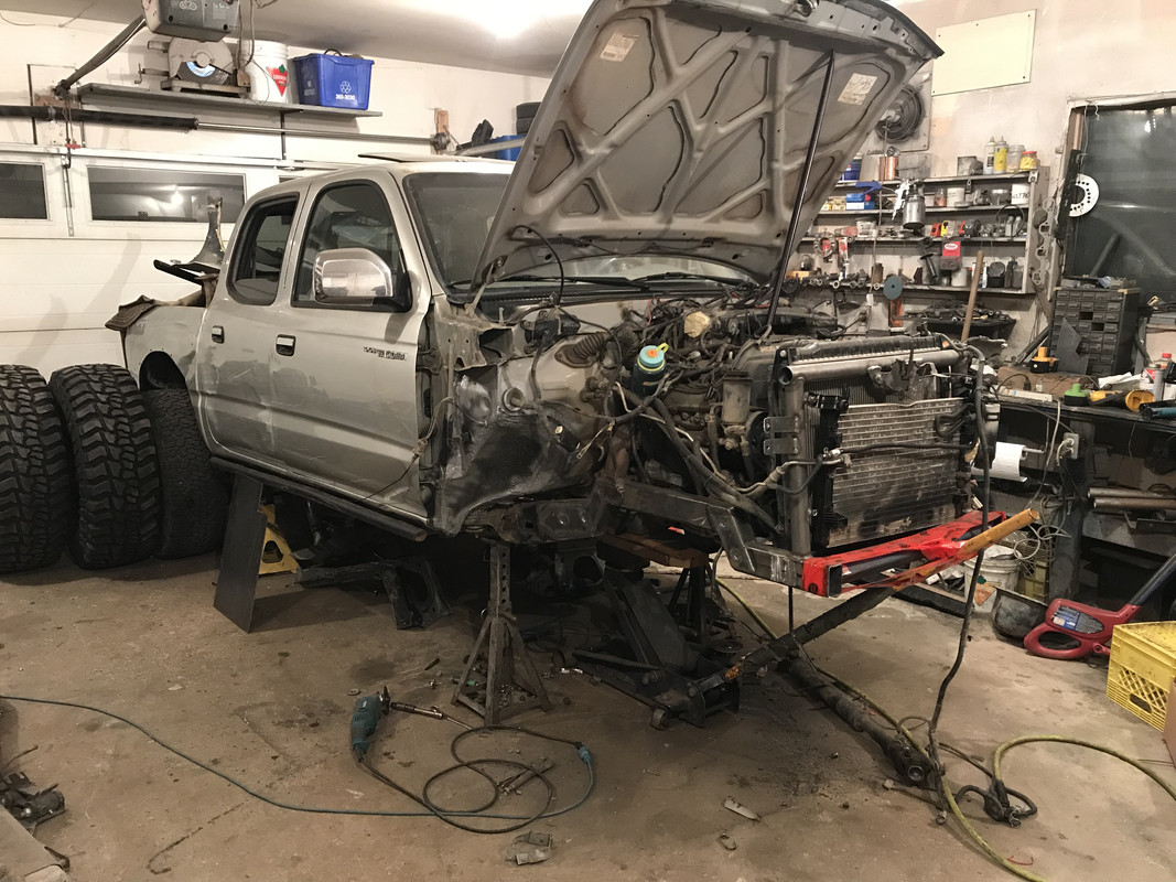

Got the frame sections cut off and fully welded, and I fish plated some of the passenger side. Making these fish plates is so satisfying.
I'm going to wait to fish plate the drivers side until I know where the steering box mounts have to go. Hopefully I'll be able to get these rails tacked in nice and square tomorrow.  And begin some plating.

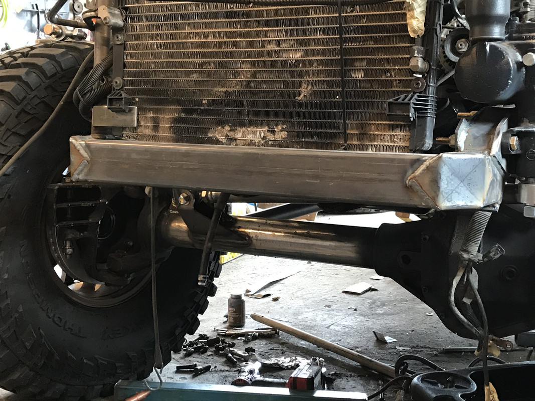

Tonight I put in a bunch of work on my upper link bracket.  It needed to be beefed up and fully welded and gusseted.  Should be solid now.  I'm hoping I don't have to add more reinforcement plates.   If my welds holds up, it'll be good enough.   It's 1/2" thick on the sides.   Didn't dress it up with holes as I wasn't feeling like plugging a bunch of holes in 3/16" and 1/4" plate.    Hidden most of the time anyway.
Got the axle wrapped again.
Welded the links up, and painted them.  Steel it seems like cool stuff.  We'll see if it's durable.  I'm planning to do pretty much all my work in steel it on this project so I can weld on it without removing paint if I have to.  it sounds durable.  Also the finish on the silver is really cool!   Can't wait to see how the front tube work looks in the silver.
Hoping tomorrow I can assemble it enough to roll it out of the garage to clean up in there.  It's a freakin' mess.  And I want to get the ride height figured out and exchange my springs if needed.

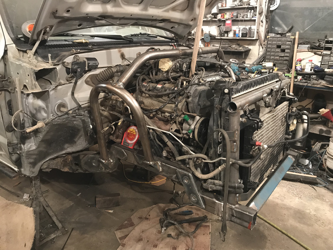

Steering box mounted, began some work on the engine cage, which ties into the front bumper.
