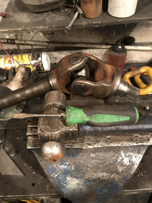

Just changed out the ujoints on my spare axle shafts.  Have a spare for every shaft now. Hopefully won't need them but ya never know!

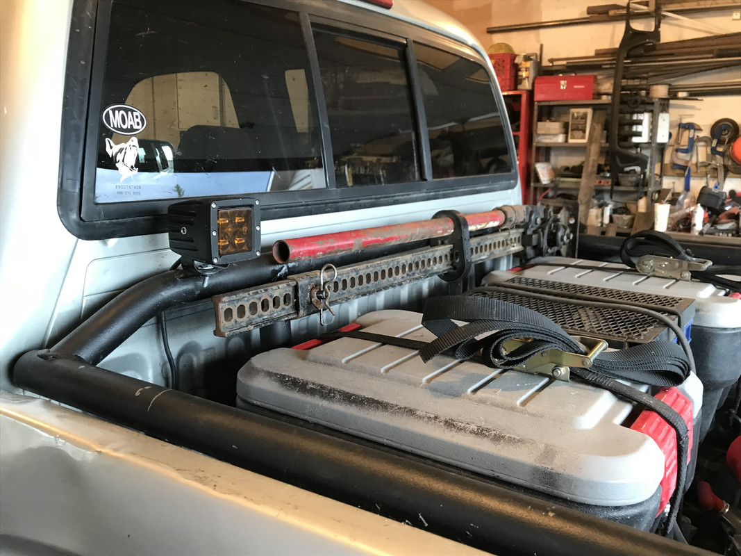

Mounted my hilift tonight. Just trying to check a bunch of things off the list before my trip.
rapier46
Checking off some boxes for Moab & mcr.
Got the hi lift mounted, and made a little rack to carry some stuff

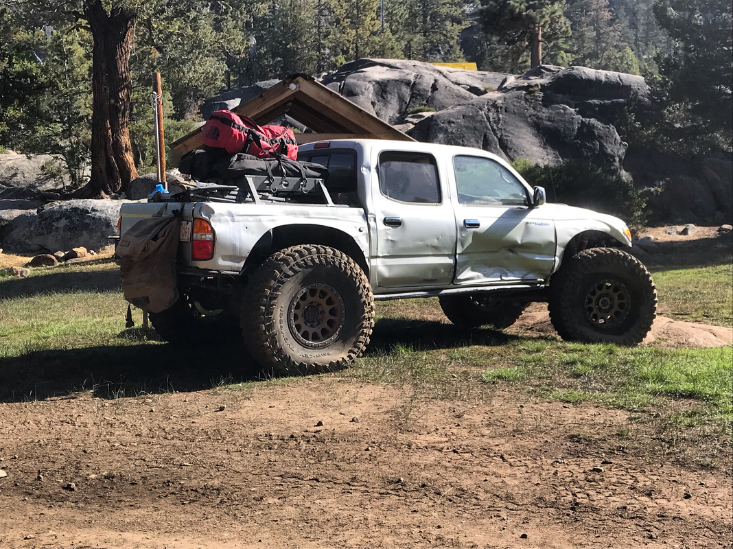

rapier46

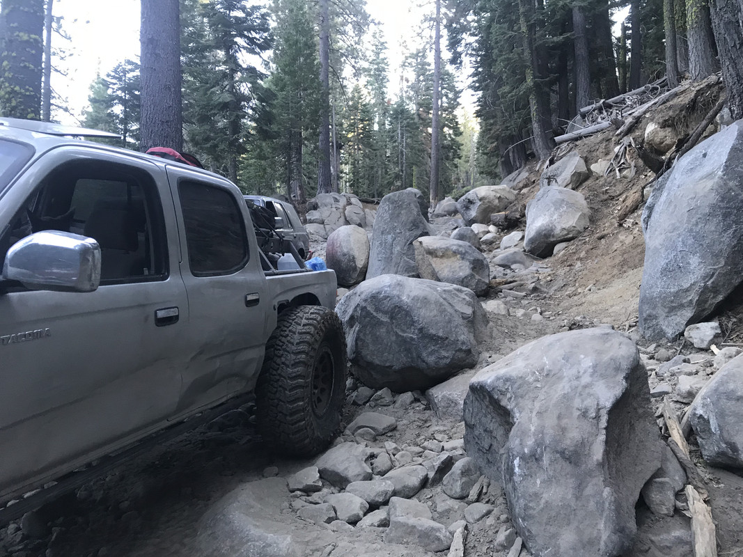

MCR18 was pretty alright I guess!
Soup bowl
https://youtu.be/MkTY8_CzA_s

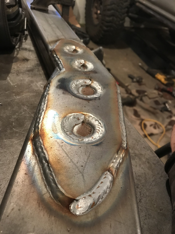

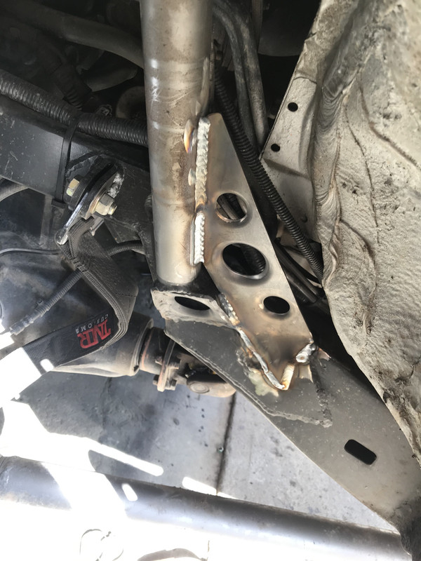

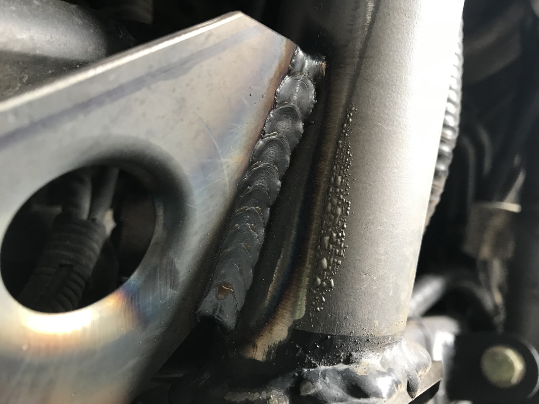

Now that I know the front end works pretty well I added some extra meat to the shock hoops.
And some smaller gussets in the front side.  Welds turned out pretty well.

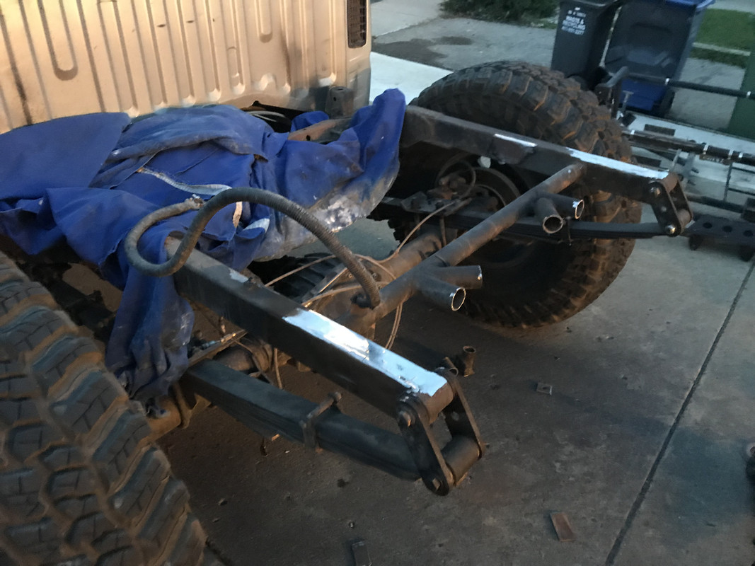

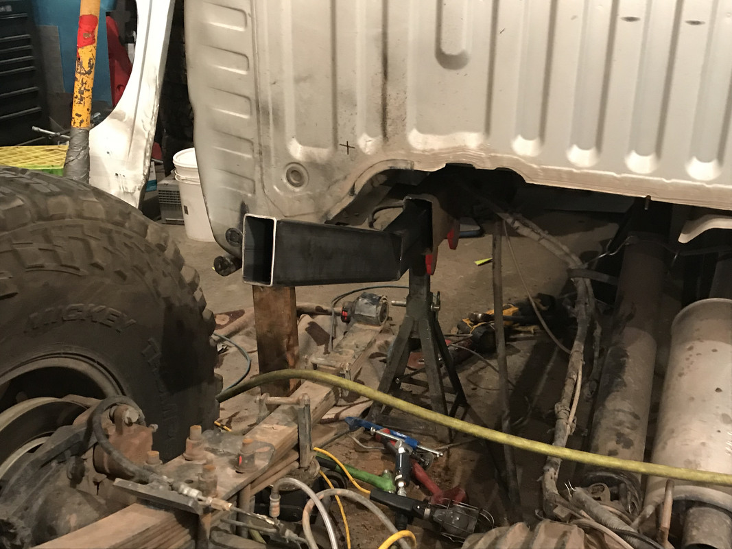

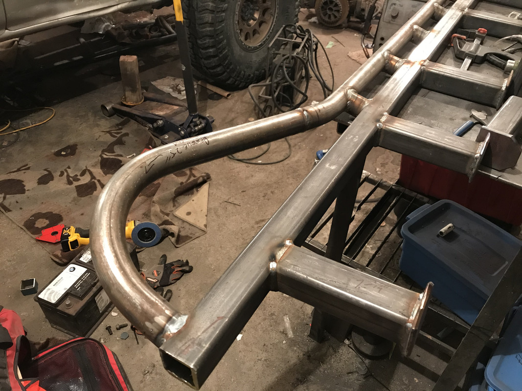

Actually got a lot done today.
Started here
Fish plated inside and out at every joint.
The the new sections welded in
Ended here
Front and rear leaf perches in,  made loads of progress today.

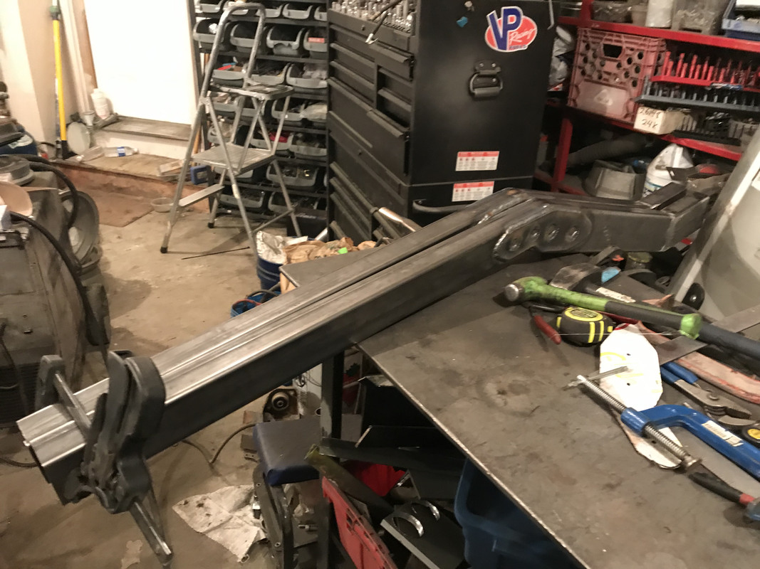

I supposed I left y'all at a cliffhanger so here's an update.

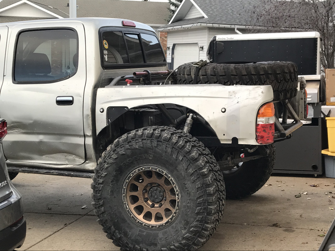

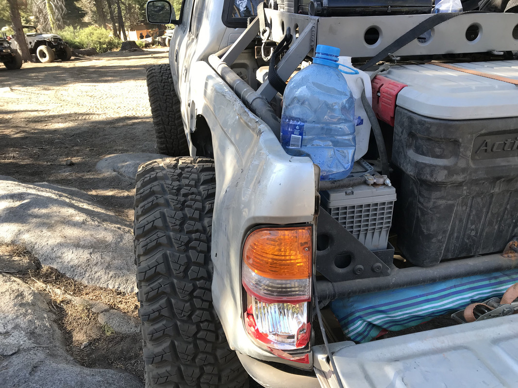

Ended up putting the bedsides back on for now after hammering them "straight".  Went to an ugly but simple and strong rear bumper for now.  No more tailgate.  But I have an idea for a tailgate in the works.

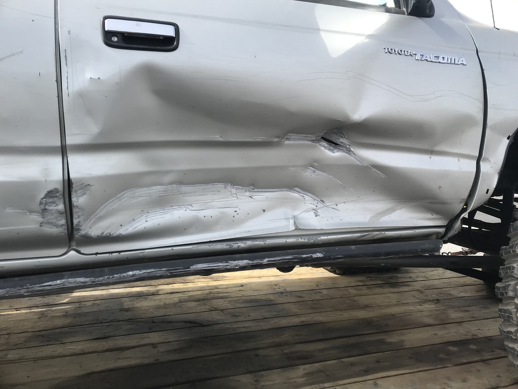

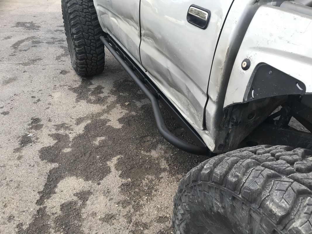

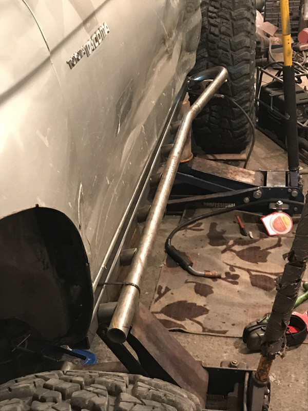

Made new sliders finally.  Along with a total of 110" of frame plates to spread out the stress. Old ones were bent to snot.  Went with a bit of a kickout this time.

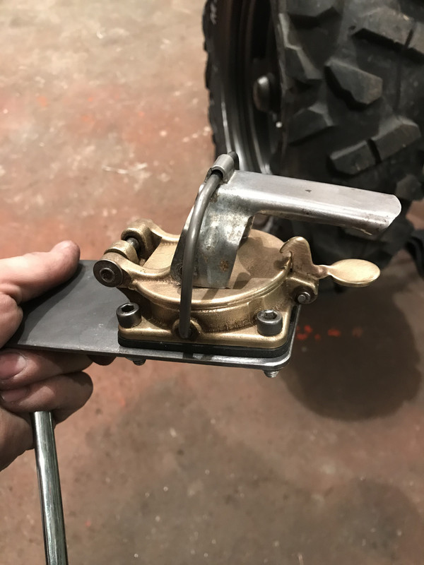

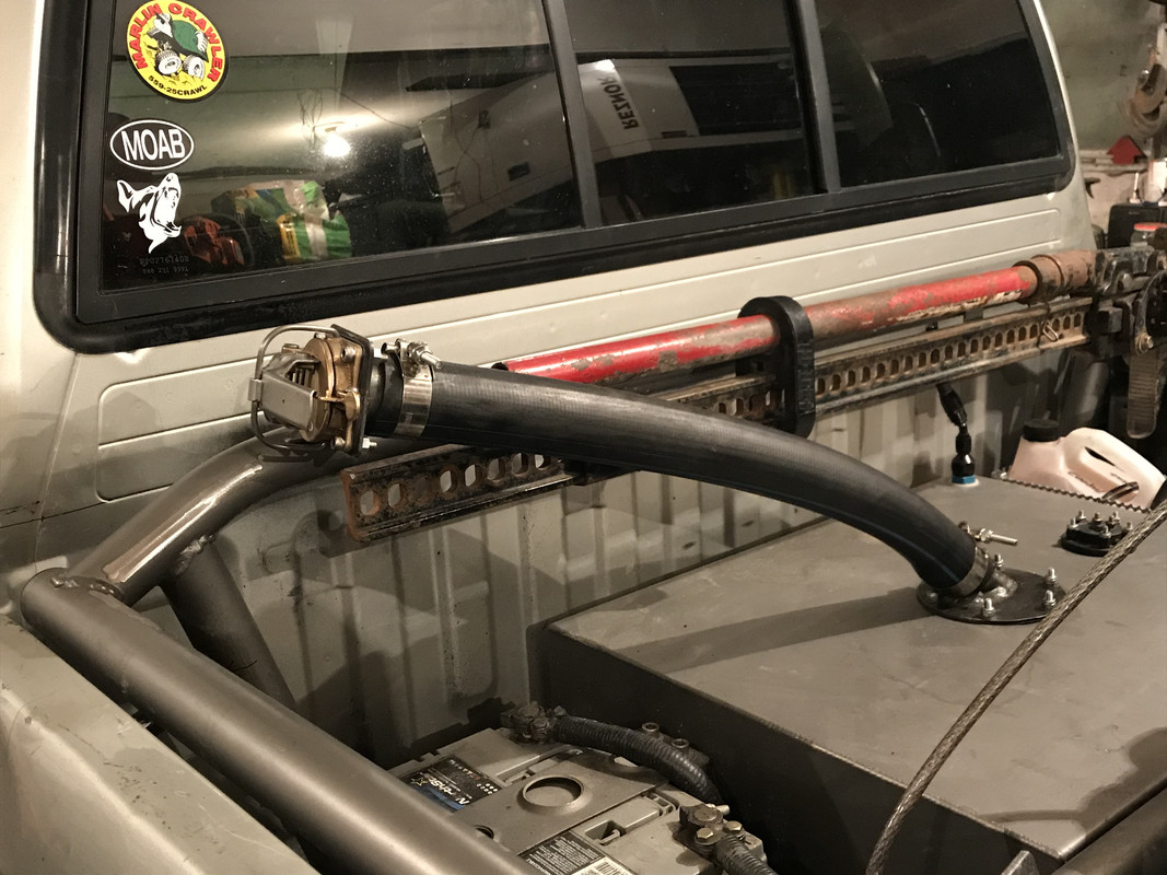

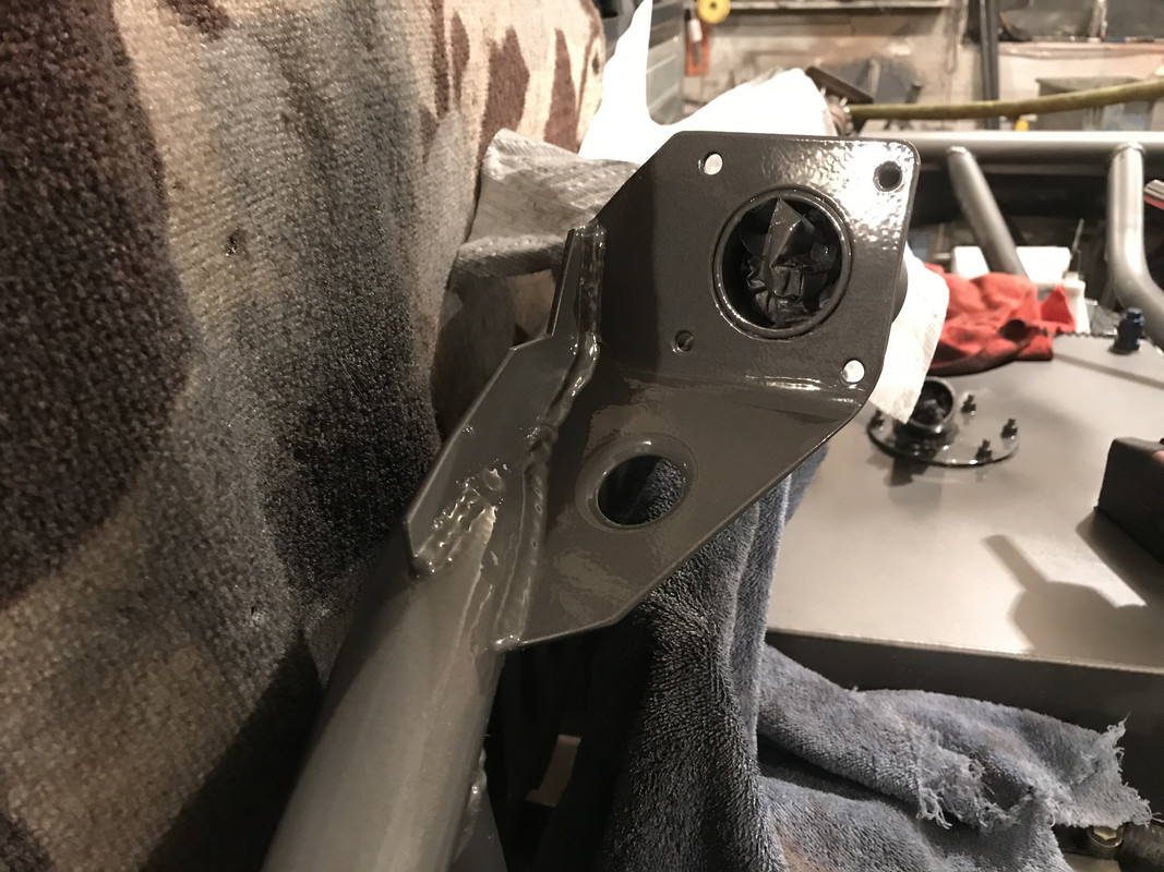

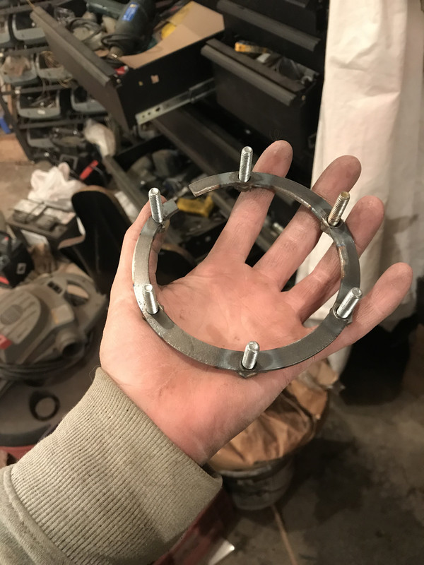

And In the last couple days been figuring out a new fuel cell filler.  The flush cap is no good for snow and a bit of a pita to fill.  I could buy a fender fill kit for a few hundred dollars, or I could make my own for about $60.
Filler from a coach, these are safe, strong, and free.
Cut some plate for it to fit into. Fits really nice.
Since the tank isn't threaded and you have to stick your hand through the filler hole to hold onto the nuts in the tank, and that would not work with a tube of those size..I came up with this.    Threaded ring that goes in, and you just nut it from the top.  Problem solved..
And made the new filler mount tonight.

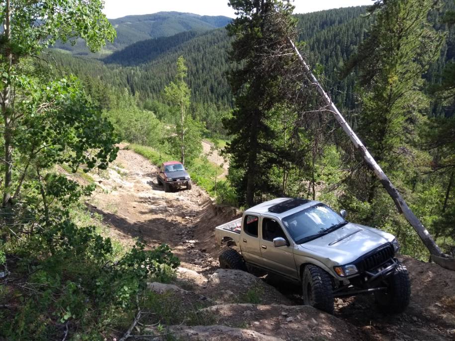

Went out with a couple old friends today.  Not much snow, and easy trails but it was fun.  I had to pull a bunch of people up a few hills.  Truck did good.
