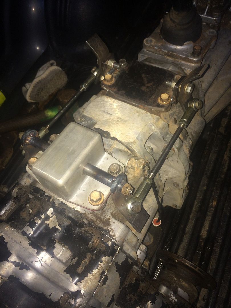

While waiting for bushings and other random little bits and pieces I pulled my cases and decided to make a relocated twin stick out of the skys twin stick. The 2wd had a really nice bench seat and I wanted to try and keep it. This is what I came up with.
I threaded some 1/2" rod to fit my shift nobs then welded them to the little taps for the shifters. After everything was done it cleared the bench seat.
