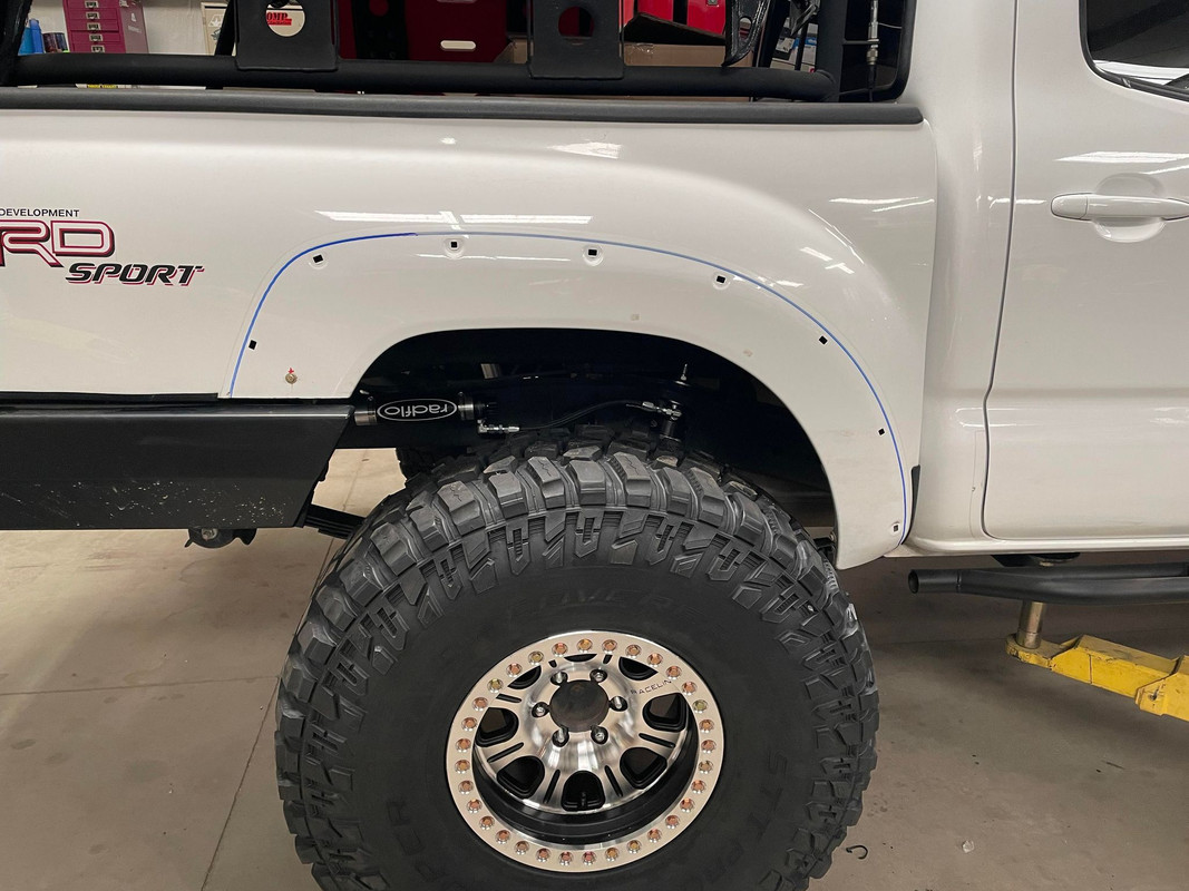

Rear end prior to trimming at full droop
All trimmed up

Nice trim job on the rear wheel openings. What tool(s) did you use to make it so clean?
The shop used a Snap-on air saw.

More photos from build. The wheel wells came out awesome!

REALLY nice body work!
