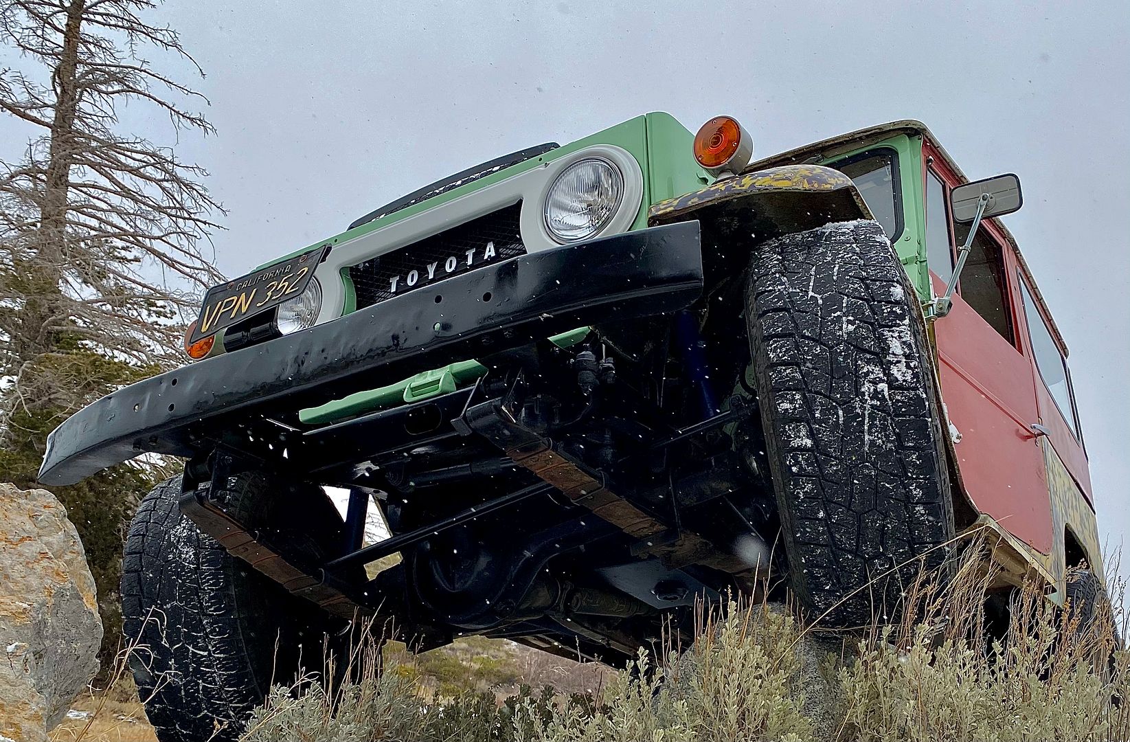

trimmed 1.5" off length of front frame horns.
Mounted up a @red line landcruiser front bumper.  beautiful piece of work!
threw on a Smittybuilt 10.5 xO2 winch that i had laying around for my 08 T4R.   Need to be able to drag this thing across the Con 😂😂😂
finished burning in the Sliders.  added a 3rd frame to slider bar and gusseted them all.  Not certain why MetalTech doesn't include of suggest this for real wheeling.  2 bars not enough.
Found a cheap waterproof cover for a Jeep on amazon that fits great.  should work nicely in the Eastern Sierra when it can snow any time of the year.   Keep those seats dry and the Bears from sniffing around and putting their paws on everything when the top is off.
next up is stout trans skid and rebuild the exhaust to fit above the frame instead of 4" below it 😂
and put some comfy seats in!!!!

took a nice spin thru the forest here in the Sierras.   Gorgeous out as everything begins to wake from Winter.
Discovered my paint scheme is quite the Spring Chameleon  Full Camo mode😂, ya hardly know im there if it wasn't for those bling Trailreadys!
The it snowed overnight     Brrrr!!  not Summer yet 🥶🥶
