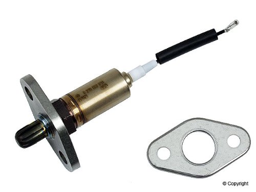

So, update time!!
Well, I haven't worked on it for a week.  Between work and mainly wife been sick, I finally got to work on it today.  Which is good and frustrating.  I finally got the 22R style exhaust manifold on.  But it took some doing.  I had to smooth out the face.  A long file, and a belt sander to smooth it out, and eliminate all the surface rust.  I used a good straight edge to check to is how true it was.  But with the graphite coated gasket, I wasn't too worried about small imperfections.
Put it on, and started putting on washers and nuts.  When to start them down.  But there was some casting preventing me from using a socket on the middle two lower ones.  WTF?!?!?!  I tried a OEM nut, nope flange hits.  Off it came.  Dremel time!!  Got it all ground down and all sharp edges all smoothed out.  Torqued up in 3 stages.  33# on the dot!  O2 sensor.  WTF???!!!???!!   Bottoms out about an 1/8" away, and won't go any further!!   :tantrum: :maddest:  This freaking exhaust manifold is fighting me the whole way!!!  So, down to the parts store, I go!  Nobody had any on hand.  And their freaking computer doesn't tell them squat. They only give overall dimensions.  Not the important ones I need, like the depth of the sensor.  I have to order them in.   :shake_head:   At this point, I am about to buy a long bit dremel stone and grind away.  I can't, I already put the manifold on!!  And I don't want to risk sending grindings in the exhaust ports.  There might be zero risk of doing it, but with the way things have gone!  Don't risk it!!!
Why didn't I test fit the O2 sensor??  I didn't need too!  It was a used manifold, so I figured it would be just fine!   :smack:
So, Advanced Auto/Carquest has a Denso and a Bosch generic coming in tomorrow morning.  I will go try them out.  Which ever one is shortest, will win!!
So tired of having 3 parts houses and neither one have the parts I need, and the only good parts I have bought was from Putney!!  And a guy at NAPA said I can't get a new o2 sensor, because it has to matched and programmed to the ECM.  I walked out on that one, and its time for a big DRINK!!!

I kinda sorta remember that the O2 sensor fit in a stepped hole that's inside the manfold.
 :dunno:
So it might be O2 tip diameter.
 :think:
Or it's just alternative memory.......

Or if this is the Toyota flanged O2 sensor, just make a spacer flange and use 2 gaskets......

I did run across a post on Pirate about this same situation.  And it was suggested that they should make a spacer and 2 gaskets.
I have two coming it at Advanced Auto Parts, OEM Denso, and a generic Bosch.  The Bosch looks smaller, but we will see tomorrow.

What did you do about the O2 sensor?

I just bought the generic Bosch sensor.  All I had to do was crimp a wire on the pigtail it comes with.
https://www.amazon.com/Bosch-12031-Oxygen-Sensor/dp/B007XB80JC/ref=sr_1_2?ie=UTF8&qid=1487827866&sr=8-2&keywords=bosch+oxygen+sensor+12031
