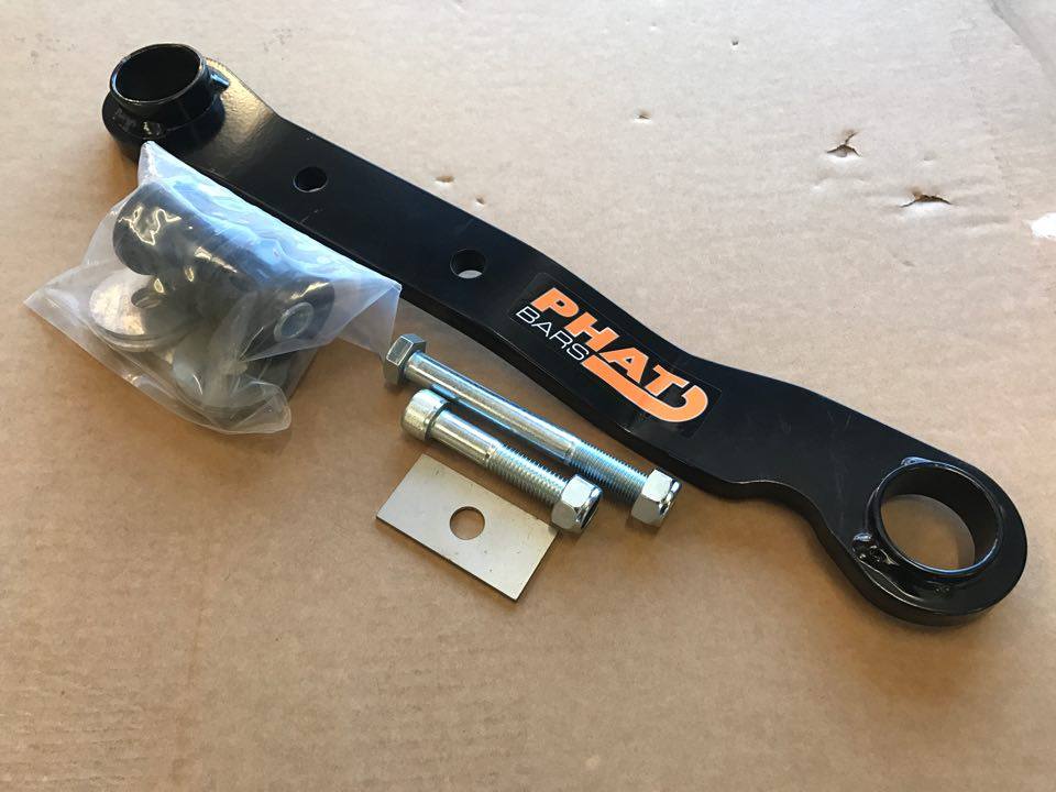

Mike, looking at this photo below,  im surprised you have never considered upgrading the standard diff bracket?
Here in Australia those that offroad their IFS Hilux's,  we replace the factory diff brackets with aftermarket ones, the RHF one braces between the front and second crossmember. they also drop the diff 32mm to both reprieve CV angle and provide additional durability.
Standard forged diff brackets have been known to bend under low in low rnage, this bending causes the CV shafts to dislocate alot easier and more frequently.
These are the diff brackets I run:
See how the bracket is braced between both crossmembers?   Given the huge torque your running, I would think this would be a good upgrade for your Tacoma.
Even the rear mount sits lower once changed.
For those that do not want a diff drop, there is simply a RHF diff braced diff bracket option to strengthen the front mounts to alleviate the torque twist I speak off damaging mounts.
just throwing some ideas your way that have proven to work here in Australia over the last 10 years!
